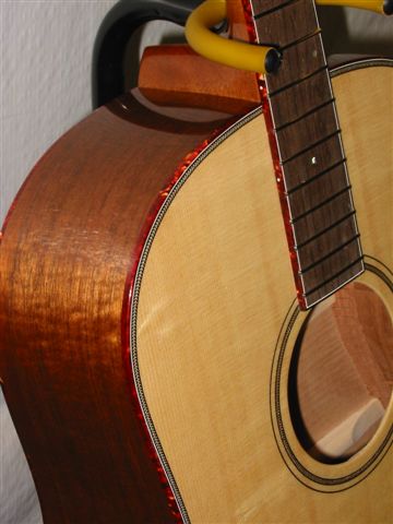

I did tortoise with a .020 white line behind it on this curly african mahogany 12 fret dred. I laminated the white line to the tortoise, and it does give the tortoise a ruby like backlit effect that is very cool indeed.
sorry my pics stink, it is much nicer looking in real life.

    I have seen this before and you are right , it is a stricking effect.
john hall

Matt, was this the unit you brough to ASIA this year?
It looks great in the picture, I like the appointments a lot, the fretboard trim is nice.

I like to do the same thing on binding fretboards - thin maple veneer first, then the tortoise, to really highlight the figure in it. Also makes the fretboards look cool from the top side as well, a border effect.
PostPosted: Fri Dec 16, 2005 12:57 am
Oops .. sorry, didnt even see the maple line on the fretboard in the picture ..never mind !!!

Lance, nope I sold that one about a month ago. This one is going to be strung up today hopefully.
John, Yes I saw this binding scheme on the Martin Peter Rowan signature 000-18, and was dying to try it.
At first I just liked the white line added and I was`nt really thinking about the backlit effect, so that was sort of a surprize bonus.

That is a beauty! I really like the binding. What method did you use for the position markers on the fretboard binding?

Thanks Jeff, I used regular white plastic dot rods, I drill them in after the f-board is bound.

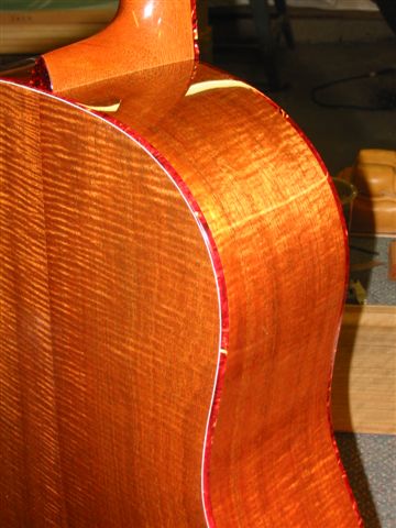

thanks again,heres a shot of the back
Matt Gage38702.6433217593
